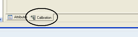

Furthermore, if you wish to check if calibration is the issue, then see if the 'Expiration Date' on the following tab in MAX is in the past:
If you have any comments and questions, please feel free to reply.

Hi Mark,
Thak you for your assistance.
The calibration staus is ok. Please see the date in the picture.

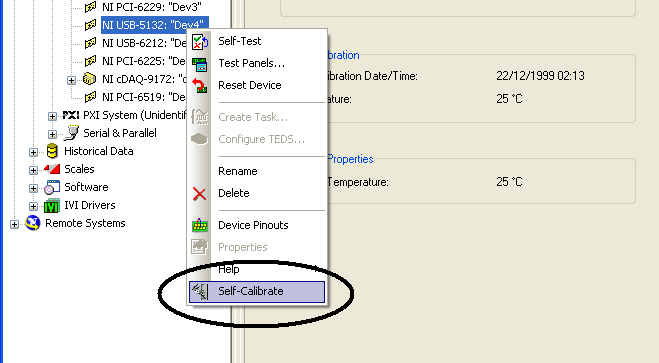

Something to try:
If this doesn't work, have you got another 5132 to try on the same computer with the same VI? This would mostly eliminate any software/driver issue.

Hi,Mark:
The self calibrate on MAX pass sucessfully!
I have not another Ni5132.
I ´ve installed software  on my laptop. The behavior is the same.
If I use a vi like "test3.vi", works OK, but when I use a vi such as  niScope Read (poly).vi or niAutoSetup.vi or anyelse, it always shows an error (the same error). ...calibrate...
Is necessary to perform an IVI session?
Ariel
