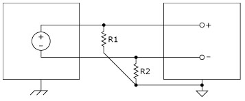

I think the issue may be with your connections.  In order to connect your thermocouple in differential mode, you are going to connect your terminals as indicated on page 12 of the NI 9205 Specifications.  Attach the positive terminal of the thermocouple to AI 0 (ch 0) and the negative terminal to AI 8 (ch 0).  The bias resistors can be any value between 10 kohm and 100 kohm.  In reference to the image below, if the signal source is DC-coupled, select any resistor that is between 10 kohm and 100kohm for R2 (R1 is not required); whereas, if the signal source is AC-coupled, include both R1 and R2, such that R1=R2.
Try connecting a bias resistor between AI 0 (pin 1) and COM (pin 17) a bias resistor between and/or AI8 (pin 19) and COM (pin 17), depending on the coupling.  Hopefully, this will correct for the noise that you're experiencing.  The inaccuracy is the result of no CJC channels available on the 9205.
