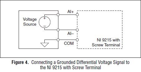

Hi AASakhno,
Try connecting your cirucit like this:
That is, instead of using the 1 MOhm resistors, directly connect COM to your Ground Reference.
The 9215 is isolated from earth ground so you need to provide a reference yourself (in this case the reference would be to ground).  My hunch is that the 1 MOhm resistor is too high of a value and is causing unexpected behavior due to any capacitance and inductance that is present in the system.  As you add more resistors in parallel the connection would get better and better.  You do not have to worry about a ground loop (the 9215 is isolated from earth ground) provided that all of your signals sources are referenced to the same ground.
