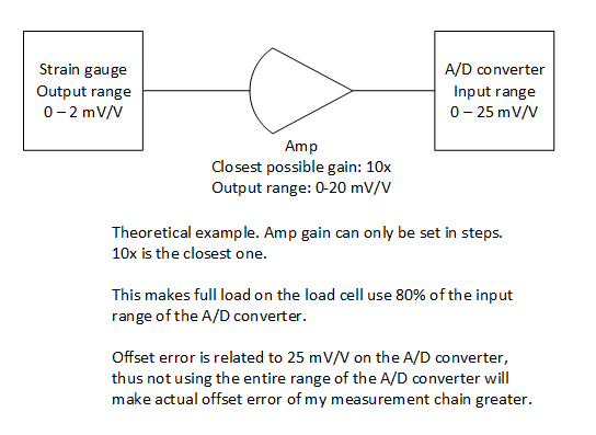

Is the amplification of the gain amplifier set in just a few steps (1, 2, 5 etc)? How do I know its setting?
And most important; how do I know what a full scale analog input to the module will actually read on the A/D converter?

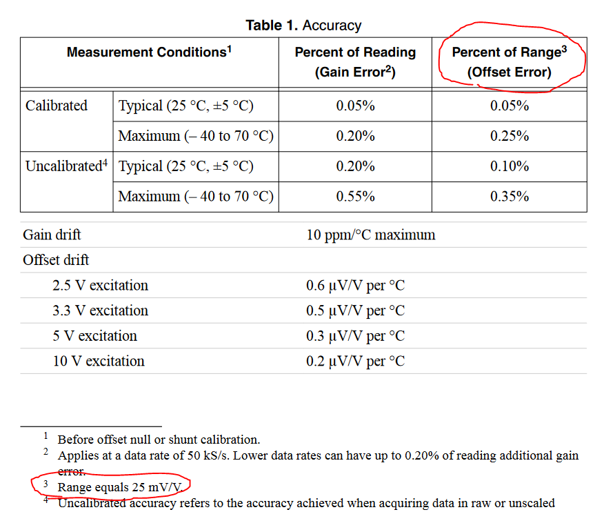

The reason I'm interested in this is that I am trying to figure out the total accuracy of my application. I understand that the offset error is relative to the range, which is 25mV/V. I guess that is the range of the A/D converter. This accuracy can only be achieved if the gain amplifier can be set so that full scale output from my load cell gives 25 mV/V. If the gain can only be programmed in steps (1, 2, 5) etc, this is not possible. I then need to know what gain is actually set to be able to calculate the real offset error of the entire measurement chain.
