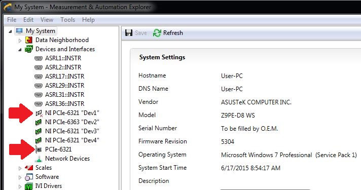

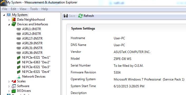

I have loaded a PC with 4 PCI daq cards 6321,6321, 6321, and 6363. After a reboot one of the 6321 cards will show with a RED X (white icon) in the M&A making it unusable and an additional card without a name is added to the list (see attached images), Device Manger still sees all four cards and claims they are working properly. When we see this error we proceed to delete the RED X item, 'Reset Configuration Data' in M&A then reboot, this brings the 6321 back to Green icon and we are able to use the system normally. This is painful to the users of the computer since two reboot are required to get the system operational.
Why would one of the cards randomly change to a Red X?
Why is it always the same card?
Why does a 'Reset Configuration Data' and reboot resolve the issue?
If this is some sort of Discovery bug with M&A, is there a mechanism to lock in the M&A settings to prevent the Red X?
Our production system uses  are using NI DAQmx 9.8. We updgraded and reproduced the issue with DAQmx 14.2 also.
Image 1: Before Reboot
Image 2: After Reboot

Does this happen only after a reboot? Or after the computer goes to sleep and then you are forced to reboot it? What happens if you delete the newly added device and then refresh MAX by going to View>>Refresh?

The sleep function is disabled on the computer so I'm not sure if it occurs then. It happens at every reboot.
Deleting the RedX item and refreshing does not bring back the card.
