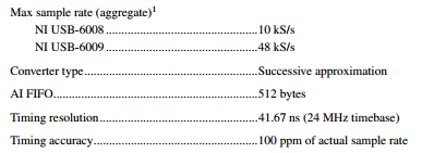

The USB 6009 supports hardware timed sampling. Here's a section from the manual.
It looks like you are setting up your task in MAX. To use hardware timing, set the "Acquisition Mode" to either "Finite Samples" or "Continuous Samples" You'll be able to set the sampling frequency "Rate (Hz)".
You might want to get rid of that loop and use the "Analog Waveform 1 Channel N Samples" version of the DAQmx read. Set 1000 as your number of samples per channel, and you'll get back a waveform data type that will work nicely with the tone measurement.
