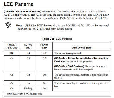

From page 45 of M Series User Manual
Depending on your DAQ device, it could be a device or USB port problem.
