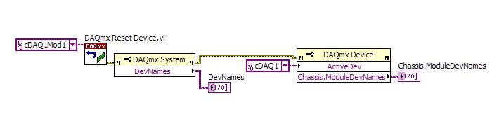

Hi, Jed.
Yes, you can reset each module individually without creating a task.  I've attached a VI (in version 8.6.1) that will not only reset your device, but also deliver all of the Device names that are on your machine, as well as all of the device names associated with a particular cDAQ chassis.  Below is a screenshot of the Block Diagram of the attached code:
If you need to individually reset more than one module within your cDAQ chassis, you can use multiple DAQmx Reset Device VIs.  (FYI:  If there were tasks associated with the device that is being reset, the tasks would be aborted, but the existence of a task is NOT required in order to use the DAQmx Reset Device VI.)
I understand that in your first post, you said that you wanted to be able to get the device name from a specific physical channel.  Since the name of the device is usually incorporated with the name of the channel, did you actually mean to get the module device name from the name of the chassis?

Hi Jed,
I have been having the same issue. I would like to have the user specify the phsyical channels to be used in the data acquisition and from this information I figured I could identify the modules that are embedded in that channel description and reset those modules. Doing this would start with a clean environement. Then I would define the tasks. I have had a hard time, like you, getting the device name which is clearly visible as the output of the physcial IO channel control (at the beginning followed by a backslash). I have found that you can flatten the names to a string and extract it this way. But there should be a build device name that bahaves like the build path functions - it seem to be an identical format.
The solution already presented doesn't really work because the device name is given manually at the beginning of the code.
-Brad
Message 7 of 8
(6,027 Views)
Never mind starting at DAQmx system it does work!
