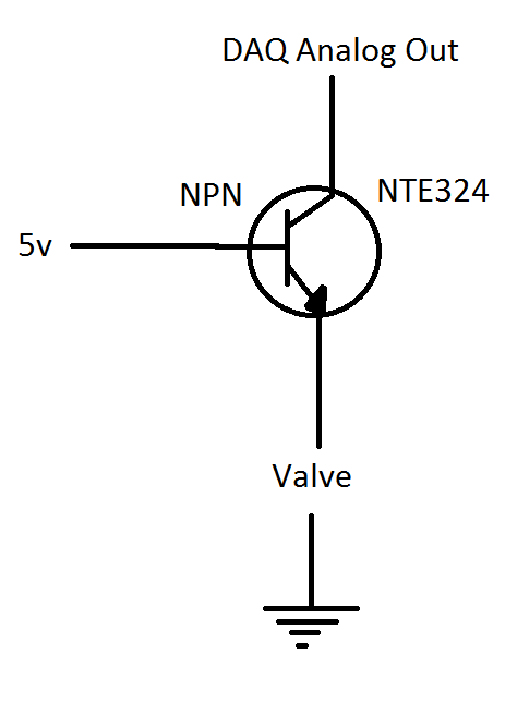

This is what ended up working. We used a different transister so it is possible the other was bad.Working SAM Circuit.png
Thanks!

That cannot possibly work as you have it drawn. It might turn the valve on and it might damage the DAQ AO line but it will not give control of the valve.  The circuit  you posted in message 4 of this thread is more appropriate.
Lynn
