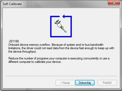

I have also the problem concerning the calibration of my PCI 6110 under XP and now again in Windows 7. Under XP was the case similar to yours (I manage that with referencing the diferential signal to AIGND), The other was that the output bufer begin to alias after the half of period. ??? (sudenly after WinXP upgrade) After all tedious attempts I finally pull out the PCI6110 and I put it into other computer with a same LabView and perhaps same driver (I try to load driver that comes along with PCI 6110  7 years ago). The DAQ card start to work normally. Even the calibration suceed.
I think the new driver don't work properly for the older PCI 6110.
The other problem I expirienced on PCI 6110 is the independant gain setting for each input channel ?!? The input gain for other channells cannot be higher than for Ch0 (LabView - Input limits for each input channel were set)

Under Win 7 is working fine but the self-calibration in MAX fails again like in XP-professional.

Hi Viktor,
This is a very unusual error.  I have never seen an onboard device memory overflow error during a self-calibrate.  Can you give me some information regarding this issue, so I can escalate it to our R&D department:
1.  What version of DAQmx are you using? (look under Software in MAX)
2.  What version of MAX are you using? (Help»About)
3.  Does this device pass the self-test?
4.  Can you open and run test panels?
5.  Can you successfully interface with the card using LabVIEW?
Let me know the answers to these questions, and hopefully, we can get you self-calibrating again. 🙂

Hello Sara,
Thank you for your effort.
1. NI-DAQmx Device driver 9.0.2
2. MAX Version 4.6.1f0
3. The device has passed the self-test
4. Test pannel works normally
5. Yes, I can successfully interface with the card using LabVIEW,
The range dependancy still remain. (for instance input limits Ch0 ±1V Ch1-3 ±200mV or ±500mV  - not accepted. Only higher input limits on Ch1-3 than on Ch0 were accepted)
