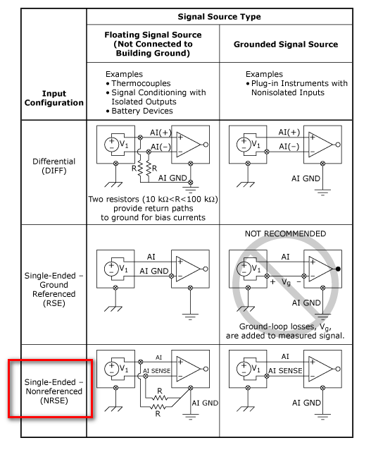

Hi Sebastian,
we talk about the ground loop if the source has a ground and the measurement system is also connected to a ground.
It creates a new signal voltage that will either
A) Cause noise in your signal (commonly 60Hz noise from phase differences in the power reference on the different grounds)
B) Break something (if the size of the voltage (potential) between the two grounds is too large)
For more information please go to  Field Wiring and Noise Considerations for Analog Signals
Floating sources do require bias resistor(s) between the AI SENSE input and the measurement system ground (AI GND) in the NRSE input configuration.
I hope this will help
Kind regards,
Houssam Kassri

Houssam, thank you very much for your input. However, as you can see from the graph I posted, noise in NRSE mode is mostly white, but significantly higher than in RSE mode. The signal source was grounded and the connection used was the bottom right in your schematic.
Anyhow, the problem was solved today in a different way: after reading the manual (... yeah, I guess we should have done that earlier...) we discovered that differential input _is_ supported on the PCI-6259, and we simply have to connect the BNC-2110 box instead of the -2111. Then, using the top right connection in your schematic, everything works as expected.
