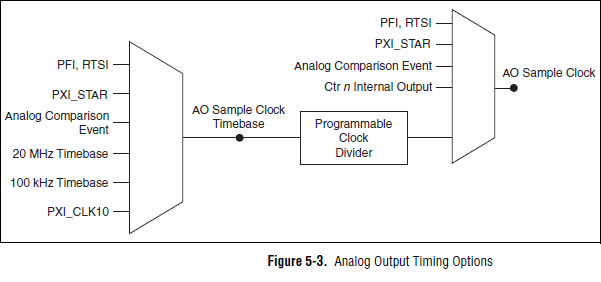

I think you're confusing the sample clock and the timebase.  By default, the AO Sample Clock is derived from the 20 MHz timebase.  However, the default sample clock is not the 20 MHz timebase, but rather a divide-down of it.  From the M Series User Manual:
                18759i116E8001FCCF36BF
-200716 is an error specific to DO tasks, are you sure this is the error you are receiving on your AO task?  Nonetheless, you should not set the 20 MHz timebase to be your sample clock source for your AO task (it will use Counter 0 to perform the routing, but the driver does let you make this route).  Rather, just leave the timing source unwired and choose the desired rate to use the divided-down 20 MHz timebase.
The DI and DO subsystems don't have their own timing engines, so the clock must come from somewhere else (the Device Routes tab in MAX will show you all of the options).  One of these options is the 10 MHz Reference Clock.  The Sample Rate input to DAQmx Timing only directly affects the sample rate if you are using the internal timing engine (remember, this doesn't exist for DI or DO tasks on an M Series).  If using an "external" source, then the Sample Rate input to DAQmx Timing.vi does not actually change the rate (but does help determine things such as default buffer size).
