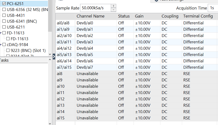

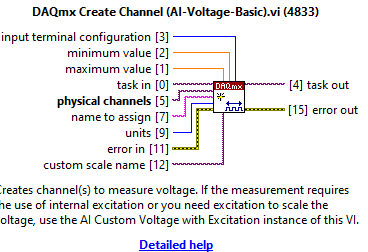

I loaded up a simulated PCI-6251 in to my general DAQ program. For the 6251 the default configuration is to set the channels to differential mode, see screenshot below. I assume in Matlab it is the doing the same thing. If you want to change the terminal configuration in the "DAQ create channel" function there should be an argument to change the terminal configuration. Note the values of this argument may seem weird, it is an I32 integer. -1 is Default,  RSE is 10083, NRSE is 10078, Differential is 10106, Pseudodifferential is 12529. Note that not all devices support all configurations. When you create the channels, you need to set the terminal configuration argument. LabVIEW function shown below, should be a similar name in Matlab.

I think mcduff got to the crux of what's been confusing for you.  The docs seem to be emphasizing default values and behavior without bringing up the valid alternatives.
Here, channels 8-15 have single-ended as a default because there are no alternatives. You cannot configure them for differential.  The convention is that only the (+) terminal of a differential pair is specified in the task config.  When doing differential, channels 0-7 are the (+) terminals while channels 8-15 are the (-) terminals.
However, channels 0-7 may be configured for single-ended along with channels 8-15.  It just isn't made obvious in this particular part of the docs.
