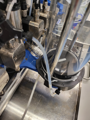

I currently have a working setup to measure and adjust the pH of a solution using a pH electrode and peristaltic pump connected to the USB-6002. I am also using a pH sensor amplifier to amplify and treat the high impedance millivolt signal coming from the pH electrode. When measuring and controlling the pH in a usual benchtop environment (glass beaker & magnet stirrer), the results look quite promising where stable and accurate measurements are achieved. However, when I want to run measurements on a solution in a reservoir of a TFF system, i get intense oscillations spanning from pH 2 to pH 8, making the whole setup unusable in this configuration. I was able to get stable and accurate readings only when disconnecting the power supply of both the laptop and pump connected to the DAQ device which is of course suboptimal. I also took measurements of the solution outside of the reservoir in the usual configuration and the measurements were once again stable and accurate.

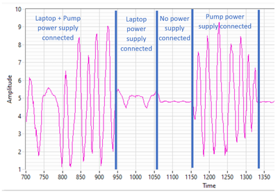

The TFF system itself of course also has built in pumps but those are not connected with my dosing setup. Concerning signal quality, this were the observations made in regards to which power supply was connected:
Concerning the power supplies, for the laptop I'm using a 65W standard AC adapter (USB type C) from Lenovo which does not come with an external ferrite bead but should still offer internal electromagnetic noise reduction from what I know. For the pump, I'm using a Mean Well NGE30E12-P1J Plug-in power supply that also doesn't come with a ferrite bead attached.
The oscillations themselves are quite low frequency however as you can see from the graph above so I'm not sure a low pass filter would help here.
I'm assuming that maybe the grounding or wiring could be an issue as when i fully unplug the TFF system, the measurements become once again stable and precise. I assume the main difference that is causing the issues is that the glass beaker in the benchtop setup is electrically isolated while the reservoir of the TFF system is connected to the system and thus there is an electrical potential causing these major oscillations. The amplifier I'm using is also not electrically isolated so that could also be a point of improvement.

Hi AtlasCH,
thanks for the graphs, that gives me a clearer picture!
A lowpass filter could still work, depending on implementation. For example moving average or butterworth filter. This would be done digitally on your PC, for example in Python. You would need to capture sufficiently many samples for the filter to have the desired effect.

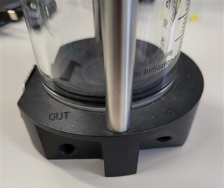

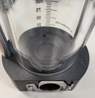

Concerning the reservoir, it is indeed a glass vessel containing the liquid to measure but it also has a pressure-based level sensor built in its base that is connected to the rest of the system via a pressure transmitter. The inlet and outlet are also both in the base:
I also tested measuring the same solution in a glass beaker in close proximity of the TFF system and in the reservoir with the power supply of the system disconnected and in both cases the measurements were stable and precise.

Regarding the reservior: It doesnt seem to be grounded since all parts are glass / plastic, hance electrically floating.

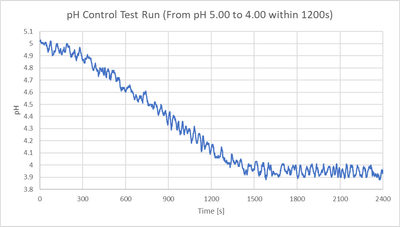

Thanks as always for your response. That's what I assumed as well regarding the reservoir. Concerning the pump, I haven't tested controlling it manually but I would assume that the signal would behave similarly like in the previous graph I posted here:
I'm not sure how I could wire the setup differently without sacrificing the automated ph regulation aspect of whole setup (e.g. manually controlling the pump). I'm considering either using a battery to power the amplifier or swapping the amplifier alltogether with one that is galvanically isolated but I'm too inexperienced with electronics to know if that would actually help with my issue.
