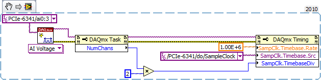

I don't have real hardware to test this, but I *think* you should look into doing something along these lines:
-Kevin P
