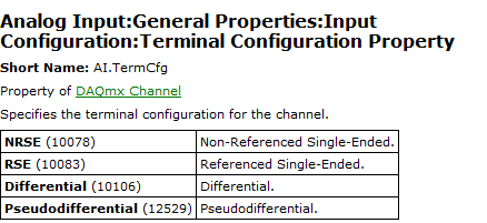

A quick look at the help for the property:
so "(AITerminalConfiguration)(10083)" should get you RSE

Thanks AITerminalConfiguration 10083 worked just fine.. Theres one thing.. i dont know how you got to get thi info from the help in the VS .. when i typed in the search AITerminalConfiguration i got this info with no number on it..

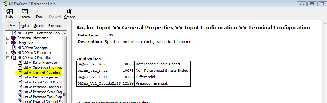

I wouldn't use the MS help.  Use the NI DAQmx (IDE) Reference Help.
(This is from the C reference Help-  No VB support on this machine)  the previous was snipped from the LabVIEW DAQmx Help
