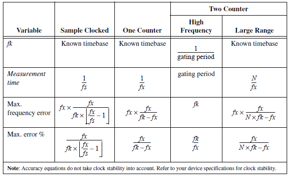

Unless your input frequency is high, I would recommend method 1.  The low frequency method essentially measures the period of the input signal using the 80 MHz timebase.  The error of this method is going to be ±1 tick of the 80 MHz timebase (12.5 ns).  The error will be more and more noticeable at higher frequencies.  The following chart has a good summary of the accuracy of each counter input method:
The Sample-Clocked method is only available on STC3-based Devices (X Series and the 9174/9178 chassis).
If you must use a 2 counter method for the input signal, then you'll have to use the correlated digital lines to generate the pulse.  In this case you could only have up to a 1 MHz "timebase" since this is the maximum update rate of digital I/O.  This method is going to be a bit more involved since you will have to generate the timebase (I would suggest using FREQ OUT) for the digital lines and build your waveform appropriately on-the-fly based off of your input signals.  You would need to disable regeneration using a DAQmx Channel Property node.
