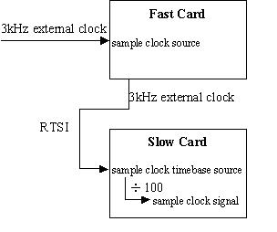

To give you the full picture, I have an external clock signal pulsing at approximately 3kHz. I feed this signal onto a PFI pin of one of my ADC cards and set this as the sample clock source on that card. This is my 'fast' card and I want to sample the signals on this card at 3kHz. I also have a second ADC card connected to the first via a RTSI cable. This is my 'slow' card and I want to sample the signals on this card at 30Hz. I therefore set the 'sample clock timebase source' on my 'slow' card to the pin receiving the external 3kHz clock. I also set the 'sample clock timebase divisor' to 100 on this 'slow' card.
So my question is, do I get the first sample on my slow card at the same time as the 1st sample on my fast card or at the same time as the 100th on the fast card?

Hi Dan
Thank you for your reply. With reference to my reply to Dominic above, I believe that you're saying that I will get the first sample on my slow card at the same time as the first sample on my fast card - is that correct? That is, assuming I have any start delays on the cards set the same (I haven't changed these from the defaults).

CAS,
I don't think it's possible to use the 3 kHz sample clock on the fast card as the sample clock timebase on the slow card, and get the first sample to align.  The fast card will sample on every pulse of the 3 kHz signal, while the slow card will need to satisfy the initial delay requirement before it can issue a sample clock.  If you make this initial delay the minimum of two ticks of the timebase, the slow card would end up sampling on the clock edges 2, 102, 202, etc.  You could set the initial delay to be 100, which means the slow card would sample on edges 100, 200, 300... but you wouldn't get a reading from the slow card on the first edge of your sample clock.

Hi Dan
That does indeed help. I don't actually need to align the first samples on the two cards, I just need to know when they happen relative to each other - which I now do thanks to your explanation.
To give the full picture, I am exporting the (30Hz) sample clock generated on the slow card to a timing card where I accurately latch the time at each pulse = the time of each slow data sample. In post-processing, I then use the latched times to accurately time stamp my acquired data. So as long as I know how each acquired time value relates to each sample, I can calculate the correct times.
