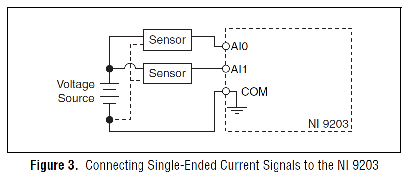

Hi Ehab,
You could use either the 9203 or the 6218 to measure current.  The 6218 would require external shunt resistors.
In general, the 4-20 mA current loop will be more resistant to a noise (voltage is dropped across the resistor of the current source).
From the 9203 Operating Instructions and Specifications, the signals would be connected as follows on the 9203:

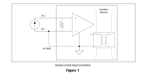

From the link in my previous post, the 6218 would be connected as so (with an external Shunt Resistor--the shunt is the resistor across + and - channels):
Both boards would be viable options--I would recommend taking a look at the links I provided earlier for more insight about noise and how to connect your signals.  Thanks for posting!

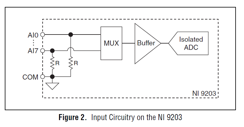

When using a differential board, you would often tie the (-) channels to the same ground to prevent the common-mode voltage from drifting outside of the range of the device.  The 9203 connects its shunt resistors internally to COM, so all of the measurements will share a common reference.  Here's another diagram from the 9203 Specifications that shows the shunt resistor configuration of the 9203:
Voltage measurements often benefit from differential configuration in the area of noise reduction, but current measurements do not work in the same way.  With current measurements, we are measuring the voltage drop across a shunt resistor that is internally (on the 9203) connected to a differential instrumentation amplifier.
