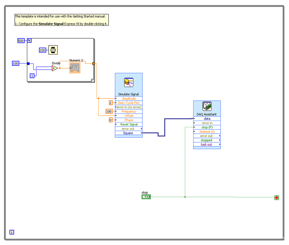

I am just starting to use LabVIEW and am currently stuck with an application I am making. I hope somebody can help me out with my question.
I need to generate a signal to a NI USB-6211 that increases with 10mV per 100ms while the signal is running. My problem is that I can't figure out how to change the parameters (offset and amplitude) of a signal while running. I can only change start the signal, change it stop it and the changes will apply when I restart it.
So how can I change the amplitude and offset while the signal is running?
This is what I came up with for now:
17425i0ABAE89D30DF2B1F

I can't change the offset and amplitude of the signal while running the VI. Is this possible? I can't seem to figure it out.

Hi Daniel,
Maybe you can have a look at the Examples which are standardly shipped with labVIEW.
If you go to the example finder, and then to the following folder:
Hardware In and Output >> DAQmx >> Analog Generation >> Voltage
Then you open the file: Gen Mult Volt Updates-SW Times.vi
This example VI provides you with the most basic (software timed) Analog Output creation task, where you can set the timing to 100ms and you provide a signal to write.
With basic Shift registers and an add function you can add 10mV every while loop iteration.
I hope this will help you design you application!

OK, thanks a lot! I have got this thing working now, by deleting the for-loop and just putting it all in the while loop.
I only have a new problem. I have to change the amplitude and offset every 100ms. I first had a wait build in that for loop that was doing the job, but in the while loop it isn't. I even got rid of totally and it is still changing every 200ms instead of every 100ms. I have tried to find tutorials about this but can't seem to find the one I need. Could someone point me in the right direction with this?

Hi Daniel,
I've been looking over your request, and created just a simple VI that is doing exactly what you want it to do:
  • Write a Voltage signal to a NI DAQ board
  • Increase the voltage level every iteration by 10mV
  • Iteration timing at 100ms
  • Offset control per iteration (in this case a constant value, but you can wire something else to it)
Please let me know if this is what you're looking for.
