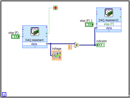

How do I light up the following attach file using the analog output.
Currently I would like to light up the led when the signal received is
more than 5 but light off when it is less than 5. So how do I go about doing it?

I suppose the simple answer would be something like the code below but I have no idea how dynamic data is handled in a situation where you have multiple samples. Just like, what is being displayed in your scalar indicator - is it the first sample, last sample, what? Do you maybe want to take the mean of all samples? What do you want to do if one sample out of all them is below 5 volts? What do you want to do if one sample out of all of them is above 5 volts? If you don't care about all of the samples, why are you taking so many?
I really avoid dynamic data so I can't even answer what is being passed to the digital DAQ Assistant - is it multiple Booleans (i.e. an array) or a single one.
