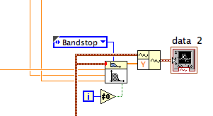

Hello, dear fellows! I am facing a problem as a novice in data acquisition: there is a test rig which consists of, apart from everything else, two displacement sensors, which acquire data of the rotor displacement over time. the data i am recieving is noisy, so i had to filter it. i use butterworth topology of a filter and for a start default settings of high cutoff and low cutoff frequencies. it is a bandstop filter since i checked the signal in frequency domain and found out the bandwidth of noise. a few words on it: there is a metal cyllinder i use to test the sensors. so when i dont move the object, the sensor shows a straight line, which means the signal i need has 0 frequency. that means that any other change in frequency domain would indicate the frequency of noise. i found out it is between apprx 4000 and 4250. but no matter how i tried the signal would not get filtered. the fact is when i send non-dynamic data (orange line lol) to the waveform out of the filter it shows ok but the signal doesnt change over real time. so i built a waveform considering the characteristics such as t0, dt of an initial waveform, but after that i recieve an even more noisy data. it might be ive been trying to solve the problem for too long i stuck at some obvious point, but i no longer have any ideas, so any help would be appreciated. thanks a lot!

Reading the help of the filter vi (I added a quick mod of your vi:
init/cont controls the initialization of the internal states. The default is FALSE. The first time this VI runs or if init/cont is FALSE, LabVIEW initializes the internal states to 0. If init/cont is TRUE, LabVIEW initializes the internal states to the final states from the previous call to this instance of this VI. To process a large data sequence that consists of smaller blocks, set this input to FALSE for the first block and to TRUE for continuous filtering of all remaining blocks.

Here is the relevant portion of the change: Connect Not Equal to Zero? to the init/cont input of the filter.

Accepted by topic author pomplamoose
here we go...
