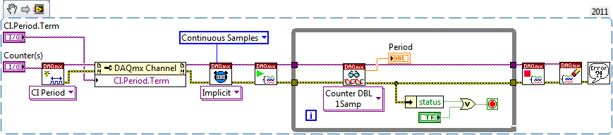

Hi Dave,
The VI you posted most recently is slightly modified from the one in the example finder (the unmodified example by that name is set to "High Frequency 2 Counter" mode--yours uses "Low Frequency 1 Counter", which is in fact the mode you want to be using).
Anyway, you are very close.  Configuring the timing to "Implicit" means a sample is taken on every rising (or falling) edge of your signal.  Note that the first sample is actually thrown away by the hardware on the 9174 (since it does not actually represent a complete "period" of the signal, but rather the time between the arming of the counter and the first edge of your signal--if you do want this first sample let me know, because there is a workaround).
The key is that DAQmx Read can read back a user-defined number of samples.  For example, with higher frequency signals, you might not be able to keep up in software if you only read back a single sample per loop iteration so in this case it would be required to read back an array of samples on every loop.
Your periods are on the order of 10-100 ms, so you can probably keep up by reading one sample per loop:
A couple possibilities of why your code might have worked and not Alexanders:
1)  If you are trying to read a large number of samples, perhaps the Read call was blocking longer than you might have expected and was not returning data before you hit the abort button.  Reading 100 samples at 100 ms intervals is 10 seconds of data which is right at the default timeout value for DAQmx Read.
2)  I noticed you started with the High Frequency 2 Counter Example but have modified it to use Low Frequency 1 Counter (which is correct for this application).  However, the High Frequency 2 Counter method uses a different default terminal for your external signal than the Low Frequency 1 Counter Method (source vs. gate respectively).  Perhaps you are connecting your external signal to the default source terminal and therefore you would only get data if using the high frequency 2 counter method.  I actually usually just specify which terminal I want to use rather than use the defaults to avoid any potential confusion.
