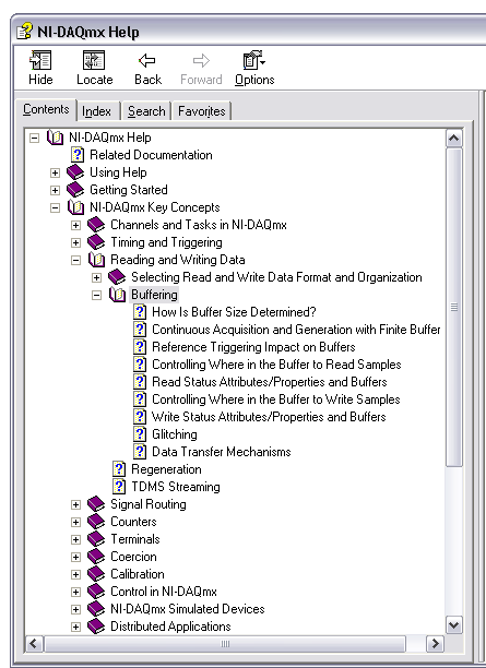

The DAQmx Help that is installed with the driver is going to be your best resource for consolidated information on how DAQmx operates.  In particular, the section on Buffering addresses some of these issues:
