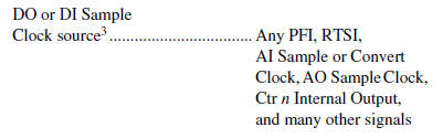

Actually, the 6289 is required to obtain the DO (or DI) Sample clock from another source (there is no built-in DO Sample Clock like there is on X Series boards).  From page 8 of the specifications:
Having said that, you should be able to use any of the counters to clock the DO task (either ctr0, ctr1, or Freq Out).  I'm not sure what gave the impression that ctr0 and ctr1 cannot generate pulses faster than 1 MHz, you could use the 80 MHz timebase to generate a 20 MHz square wave if desired (this would be too fast for the 10 MHz DO limit).  You can certainly generate a 10 MHz clock with either of the counters.
What error do you receive when trying to use Freq Out?  This should work without any issues, could you post your code and the specific error message that you are receiving?  The available frequencies for Freq Out are {10 MHz, 100 kHz} / {1:16}.
