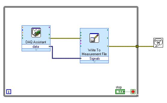

The problem we have now is that although we set the parameters of 100 samples to read, and 1k Rate (Hz) in NI 9205,
we actually get only like 3~4 samples per second. This is far from we were expected.
Is there any way to improve the sampling rate?
The attachments are our Labview diagram as well as the configuration of NI 9205.
Does anyone have same experience about this?
Any comment will be appreciated.

Hi Paul,
I'm getting 3~4 chucks of 100 samples per second that I was expected.
The sample rate I verified was by using the write-to-measurement-file component to write 16 channels mesurement data in a file to the disk.
I thought this might be the file I/O latency problem, but, when I removed the write-to-file component in labview code, the waveform monitor still shown 3~4 chucks per second.
I tried to increase the rate to call DAQmx from 1k Hz to 7k Hz, and I got faster sample rate of 6~7 chunks of 100 samples.
Please see the attachment DAQ_config.jpeg for the DAQmx configuration and voltage_all_channels.txt for the output file
In addition, I also tried to increase number of samples to read in the DAQ configuration, but this didn't increase the sample rate.
I appreciate your suggestions on this!!
Elson

Hi again Elson,
I apologize, I didn't see your pictures in the first post.  The reason you are only getting a few chunks of 100 samples is because you are doing an N-sampled acquisition each iteration of the loop.  If you want to continuously acquire at a specified rate you will need to selection Continuous acquisition.  I've gone ahead and attached some pictures of my setup.  With Continuous acquisition, you're not having to spend time to reinitialize the task every iteration of the loop which slows down the actual acquisition and creates gaps between when each sample chunk is started and taken.

This works!!!
I'm now able to acquire 100 samples per second in the way you suggested.
I'm really appreciated your help.
Thank you very much!!
