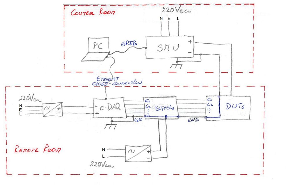

Hi Jhon:
Now I am very confused. Today I repeated the measurement with the oscilloscope, power supply in question and Power Resistance of 22Ohm. The noise was not present, but this time oscilloscope and power supply were connected at the same power strip and I don't remember how they were connected the last time (around  one month ago).
In any case, the schematics of connections are attached follow. I ilustrated in not thecnical schematics the connections before and after that I found "the practical solution" changing the power supply of c-DAQ 9184. As you can see, by the application I can not connect all equipments at the same power strip but looking by a solution, I noticed that effectively the power supply NI P/N: 190415B-01 has isolated de CC output voltage from earth AC lead. Even I also noted that the lead of negative input bias voltage has connectivity with c-DAQ chasis. I think that in any moment there was a ground loop. But I could do a misstake in this, if you look a ground loop, Could you show me where it is? Thanks.
Also, I am using NI-9205 aquisition module and I getting signals in NRSE. But I did several tests with NRSE, RSE and Differential configurations and in all cases I was getting very hard 50 Hz noise. Also, another thing is that the DUTs block very high impedances in the output signal channels but I dont think that this could be the problem.
I was forgetting, as I resolved the 50 Hz noise I dismantling the system until future use but as general practice for testing I did several measurements over only the system without DUTs and the results in Data aquired showed that the noise was also present but only the positive part of sinusoidal 50 Hz due to the buffer circuit is only bias with positive voltage. From several measurements I could detect also that noise was higher in Channel 1 and lower in Channel 8 (Last channel) in my system input references obviously.
Thanks in advance by your observations.
