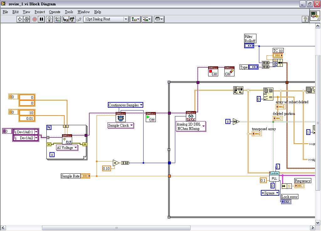

I revised the vi as following:
But only the last task is output from the for loop, so I can merely acquire the voltage from physical channel 2. I tried to enable the indexing of the output task, so both task can be output, but it failed to input more than one task into the DAQmx timing.vi.  Could you please give me more suggestion? What I need is to continuously acquire the voltage from channel 0 and 1 to decompose the signal, and also acquire the voltage from channel 2. The problem is the voltage from channel 0 and 1 is much larger than that from channel 2, so if I set the voltage range of both task in the same scale, I can't resolve all signals.

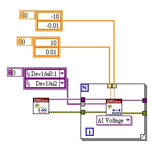

You've got the task output autoindexed and that is not correct. Try the code below.

It works!! Thank you very much, Dennis. You truely do me a big favor and help me to understand DAQmx further. May I ask one more question? Why can't I use the syntax "Dev1/ai0:1"? I thought I can use this syntax cuz the voltage range of channel 0 and 1 is the same.
Message 7 of 8
(5,091 Views)
Sorry, the reason should be the auto indexing.
 Thank you again!
