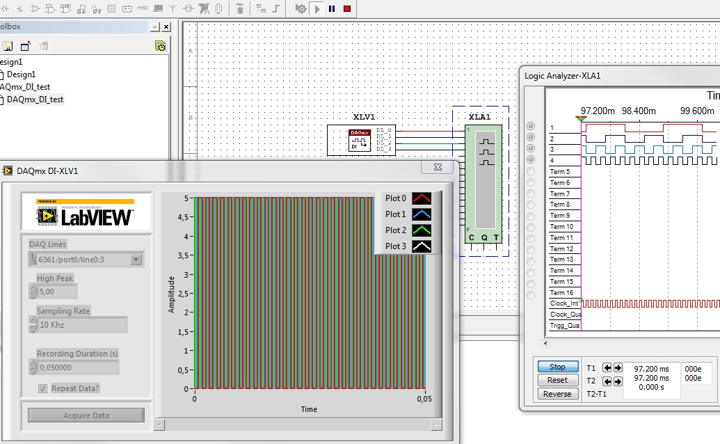

A very simple example to use a DAQmx Digital Input in MultiSIM. The internal frequency generator is
used to generate the sample frequency. for the digital inputs.
Unpack the archive to the Multisim installation directory. The table illustrates the files that will be copied to your harddrive.

Instrument Features
The following describes the function of the various controls
  • DAQ Lines(s) specifies the names of the physical channels from a particular DAQ device. Select channels from the drop down list (press STRG to select multiple entries) or enter lines string manually (e.g. Dev1/ai0:3).
  • High Peak specify the maximum value you expect to give out as an digital high.
  • Sampling Rate specifies the sampling rate in samples per channel per second.
  • Recording Duration (s) specifies the amount of time a DAQ operation will read input data
    • #Data point = Recording Duration(s) * Sample Rate (Hz)
  • Repeat Data? specifies if Multisim automatically repeats your acquired data. If you use periodic signals, it is recommended to only sample one period and check the Repeat Data? checkbox.
  • Acquire Data will update the graph with a new set of input data.
How To Use This Instrument
If you are familiar with Dataacquisition from National Instrument, you will find it easy to use the DAQ Source instrument.
However, here are some simple steps we recommend to follow when using the DAQ Source for the first time.
  1. Verify a NI DAQ device is connected to or plugged into your computer
  2. Open Multisim and create your circuit
  3. Add the DAQmx_DI to your schematic
    1. Access the DAQmx DI from the instrument toolbar
    2. Place it on your schematic
    3. Wire it to the desired net
  4. Input real world data
    1. Double click the instrument symbol to open the interface
    2. Enter the channels you like to measure
    3. Set Lines, High Peak, Value, Sampling Rate and Recording Duration (s) to match your expected signal
    4. Press the Acquire Data control to get a new reading and update the graph
  5. Start the simulation
