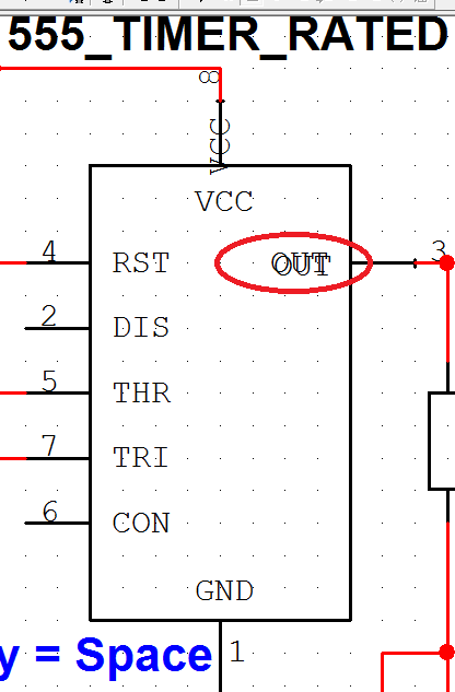

I think you might be confusing 2 things:
- At one side you have the graphical representation in Multisim by a graphical block with inputs and outputs(RST,DIS, THR,TRI,CON, VCC, GND, OUT)
This does not have any specific footprint connected to it. It is a "virtual-only" component.
This means that the model of a 555 is simulated when you run your simulation.
- At the other side you have the footprint pin-out from that website which shows the actual pins of the IC and how these should be physically connected on the breadbord.
These are two things that can be completely separate from eachother especially if you're working with simulated components.
Multisim doesn't show the footprint or the IC you're placing. In this case it just shows a virtual representation of a 555-component that is not linked with any specific footprint pin (because there is no footprint linked to it)
So Multisim does not have any pins switched in this case (see attachment). It just shows a visual representation of the 555-model and its inputs and outputs.
It just defines your inputs and outputs and outputs and a model that is usesd behind the scenes for simulation purposes.
This means that
- the VCC input of the 555 component in Multisim is linked with the VCC in the model.
- the CON/CV input in Multisim is linked to the CON/CV that is used in the model.
Even if a certain circuit is linked to a footprint, you can still have a virtual representation that is different from the actual physical pin-out (if you want to confuse people).
In the attachment you can clearly see that the descriptive inputs and outputs are not correctly linked in your original schematic and they are inthe later one I sent to you.
I think you might have been focusing a bit too much on how the people on the website virtually represented the specific 555.
You should focus on the names of the inputs and outputs to know what you're connecting.
Especially when you're working with Virtual Only components (that are not linked to any footprint) you should not focus on the pin numbers of your specific IC.
If you use a different IC these pin-numbers could be totally different.
If anything is not clear or if I confused you, then please let me know so that I can clarify a bit more.
Kind Regards,
Thierry C - CLA, CTA - Senior R&D Engineer (Former Support Engineer) - National Instruments
If someone helped you, let them know. Mark as solved and/or give a kudo. 😉

If I simulate your version of de circuit and hit the button, the LED turns on. After hitting it again, I get an error: "a simulation error has occurred, would you like to run the convergence assistant to attempt to resolve this problem automatically.".
To me, your version seems wrong because pins 5 and 7 are used while those are not connected in the example circuit and are also not connected on the breadboard, which works! Shouldn't the pins displayed by Multisim match the pins on the actual physical chip? Or at least show the right description? The descriptions of pins 1, 3, 4 and 8 match, according to multiple sources. 1 = GND, 3 = OUT, 4= RST and 8 = VCC, same in Multisim.
All sources I have found, including the wiki link you posted, say that the descriptions of the other pins are: pin 2 = TRI, 5 = CON/CV, 6 = THR and 7 = DIS while Multisim displays those wrong. Don't think there's any doubt about that. Something which someone already mentioned 6 years a go. I would've expected this to be fixed. But no one from NI has ever responded in that topic.
But how can you say I have to use two wrong pins while I have a working circuit on a breadboard using pins 6 and 2 instead of 5 and 7, plus there's a video to proof it from the original maker of the circuit?
It still looks like the descriptions have been mixed up in the 555 model in Multisim and there's still no explanation why other latching circuits, transistor based ones, also do not work in Multisim. They show the same behaviour, LED always on.

Hello Bart,
Before going into further "yes/no" discussions.
I know that there were some issues in older versions related to the 555.
I have even reported them myselves, so do not think that I'm unaware of those.
The only thing is that at my side the uploaded schematic seems to work correctly:
When I simulate my version (the one attached), then it works as follows:
- Pressing the switch makes the LED go either from "on" to "off" or from "off" to "on"
That is what you want to obtain, correct?
Let us first see which version of Multisim you are exactly using, because you might be using an older Multisim application/database version than me.
This could cause you to see different results than me.
What is the build number of your version? (See Help > About Multisim)
My "Application Version" says: 12.0.1 (12.0.923)
Do you also have version 12.0.923 or older?
What is your database version?
Is it 12.0.c or older (eg. 12.0.a)?
If one of both versions are older, then please update to the most recent version:
http://joule.ni.com/nidu/cds/view/p/id/3596/lang/en
Sidenote:
Why are you talking about pin 5 and 7 seeing that the 555 component is purely virtual in your schematic?
The pin numbers of the physical IC you're using are in the schematic you sent in no way linked to a footprint.
The virtual component is only linked to a model in which the inputs and outputs and not to the footprint of an IC.
Maybe this might make it abit clearer:
- The wiki describes a specific IC: NE555
http://nl.wikipedia.org/wiki/NE555
This wiki shows yet another "schematic representation" of a 555.
There is in this case no "wrong" representation.
- The Virtual Component describes no specific IC. It just provides you an interface with the model of a 555.
  That virtual component has inputs and outputs (RST,DIS, THR,TRI,CON, VCC, GND, OUT) that should only be linked to the model of the virtual component.
  The position of them should not be directly associated with the pin on your IC.
If you want to associate a Component in Multisim with the specific pins of an IC, then you need the following:
- The description of which inputs and outputs you have in your Multisim Component
- How these inputs and outputs map to the specific "pins" of your IC.
This is normally done by a sort of mapping table (called pin mapping table).
This mapping table does not always map "virtual pin 1" to "physical pin 1", etc.
Is this difference between a schematic representation of a component and the "physical" footprint completely clear to you?
This link you sent is as you correctly state the footprint of the NE555:
http://circuits.datasheetdir.com/214/STMICROELECTRONICS-NE555-pinout.jpg
This link indeed shows a possible schematic representation of a Component in a simulation program:
http://commons.wikimedia.org/wiki/File:555-schem.svg
The way in Multisim is just another possible schematic representation.
Please note that this representation does not show any "footprint pin names". It just shows "symbol(ic) pin names".

Hello Bart,
I also want to rectify  that I never said that your Breadboard was wrongly configured in any way.
The only thing I said was that
- You might have misunderstood how virtual components works.
  In other words: that the "symbolic pins" in Multisim are not directly linked to the "footprint pins" on your IC.
- To help you fix the simulation issues you should wire the schematic differently.
PS: My only goal here is to make you succesful and to help you understand what is going wrong.
If in the end there still would be a bug, then I would have no problems in reporting this to R&D.
PPS: We will go into the issue you're encountering with the transistors once this one is resolved.

"Why are you talking about pin 5 and 7 seeing that the 555 component is purely virtual in your schematic?"
Even though it is virtual, I expect the pin mapping (pinnumber <-> function) of components in Multisim to be correct, as in matching the datasheet. Half of the 555's pins match the function mentioned next to it, I would've expected the other half to match as well. Now it just seems someone (partially) screwed up mapping the functions to the appropriate pinnumbers.
I understand the difference, but this "mapping error" only causes confusion with users of Multisim. Especially since half of the mapping is correct and some example circuits only list pinnumbers, not functions. Take http://www.eleccircuit.com/wp-content/uploads/2009/08/simple-pulse-generator-by-ic-555-timer.jpg for example, the only info you got about the 555 is which pinnumbers go where. If you let Multisim display the numbers of the pins because the example circuit does not list the functions instead of pinnumbers, users do not end up with a working circuit because the mapping does not completely match the datasheet.
Place yourself in the shoes of a Multisim user who only knows you can simulate circuits in Multisim, but does not know anything about what you said. Wouldn't you ask yourself the same thing if you run into this? Why is my circuit not working and why do not all the pins match up with the datasheet?
But long story short. it is just a coincidence that some pinnumbers match up with the function from the datasheet?
While typing this message I got an idea, well idea, more like a hunch. Multisim doesn't simulate in realtime, a second in real life is only a few dozen or maybe hundred milliseconds of time in the simulation, part of the reason it's so slow is that Multisim is still not capable of using more than one CPU core while simulating and of course the complexity of the circuit also has a great influence on this. In my case a CPU that mostly runs throttled down also influences this, especially since it doesn't automaticly throttle up when starting a simulation in Multisim. (see http://forums.ni.com/t5/Circuit-Design-Suite-Multisim/Multisim-11-only-uses-one-CPU-core-during-simu... )
Anyway, the hunch was that I maybe was hitting the button too fast, when compared to how fast the simulation is running. So I waited a few seconds (few hundred milliseconds in simulation) before I hit the button again and that seems to be the solution for the 555 circuit, plus of course connecting the right pins 😉

Hello Bart,
First of all thanks for the feedback!
A) About the error you’re still encountering.
Are you using the default simulation and analysis settings?
Can you save your simulation settings and share them with me?
B) About the “pin mapping error” you refer to:
The first step that anyone should do when you start from an example that only mentions IC pin numbers and not the signal names is look for the datasheet and open it.
Then you should link the IC pin numbers to the actual signals.
This is the only correct way to really understand circuits and use examples you find online.
This will cause you to fully understand what is going on in the electrical circuit.
If I do that at my side, then the first datasheet I find is this one:
http://datasheetreference.com/datasheets/fairchild_ne555_datasheet.pdf
-          Page 1 shows the internal block diagram of the IC and which signal is at which physical pin.
-          In the datasheet itself you also find a schematic virtualization on page 4.
-          Now take a look back at the virtual representation you mention:
           This virtual representation is not the one that they use in the actual datasheet of the product. Nor is the virtual representation in Multisim the same as in the datasheet.
           Depending on which simulation program you are using you will see even more different shapes (like on the wiki-page I mentioned before).
           If you want you could make the virtual representation a circle with 8 connectors or a triangle… (Not that many programs would do this, but you could if you wanted to. 😉 )
Just think about how an op-amp is represented in graphical simulation programs.
There they also just choose for the well-know triangular symbol, while the actual IC looks totally different. (rectangular)
Please also note that for the example with the 555 you’re referring to Multisim does not use pin numbers to identify the inputs at my side. It is using the signal names, which is (for me personally) the least confusing way to represent a circuit in a schematic way and (for me personally again) the best way to have a clear idea of what is happening in a circuit.
C) To come back to one of your final questions “it is just a coincidence that some pinnumbers match up with the function from the datasheet?”:
At my side Multisim doesn’t mention any pin-numbers. It only mentions the signal names.
Can you show me through a screenshot where it shows numbers at your side.
If the schematic would use “numbers” instead of “signal names”, then I would agree that this could be extremely confusing.
About putting myself in the shoes of a Multisim (or any other simulation software) user.
Believe it or not , but some time ago I was an electronics students.
And I experienced the transfer from non-visual simulation programs (typing everything in text) to visual simulation programs (actually Multisim).
In both Visual and non-visual simulation programs similar confusing situations can occur.
To focus on the “visual simulation programs” like Multisim.
The first thing you should always check when using an existing example (from online or offline resources) is which signals are at which pins of your IC.
If you look at an online virtual representation (eg. Screenshot from a simulation program with a virtual representation on it) people will/should generally read which signal names are there.
If the signal names are not on that virtual representation/schematic (only numbers), then the first reflex should be to take a look at the datasheet to see which signal names correspond to that specific “pin number”.
This reflex is also what my original electronics teachers always learned my peers during the courses:
"To understand what is happening on a circuit you need to understand what is wired to which signal inputs (by their names and not their pins) of your components."
About the performance issues:
I would suggest that we continue about this in another thread.
Would you like me to use the already existing one or would you prefer to create a new one?
Thanks for any future feedback!

One of the things I usually do is enable "show footprint pin names" on the display-tab in the properties of certain components with more than two pins. 2-pin components usually have a pin that has to be hooked up to a power source and the other to ground, not much can go wrong there. With components that have more pins, I enable that setting to show pinnumbers, which makes it a bit easier if they happen to match up with the datasheet. This is the 1st time I ran into this problem though, that the pinlayout wasn't matching the functions.
Here's a screenshot with pinnumbers displayed.:

C) That's it, the "show footprint pin names" setting on that window.
"It seems that I did encounter a different visualization bug (not related to the numbers)."
Let me guess, you noticed the double output description almost on top of eachother?
