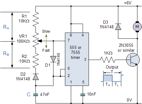

I want to design a Speed Control of DC Motor using Induction motor, required for my school project. I am new to MultiSIM and stuck at finding the motor that is shown in the diagram.
All I can find is Motor_1A Motor_2A while searching the database with the keyword 'Motor' which is not the one that I require. Can someone please tell me where can I find this motor that is displayed?
Also, how can I display the PWM? Do I need to connect the Oscilloscope for that?
