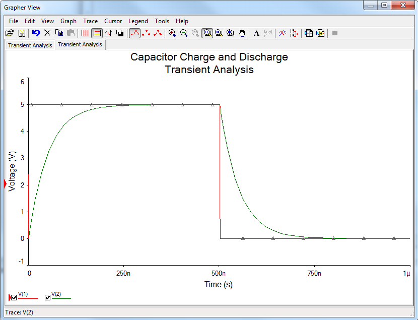

I choose the PULSE_VOLTAGE as the source to see the charging and discharging process, the parameters are shown below:
Initial Value = 0V
Pulsed Value = 5V
Pulse Width = 500ns
Period = 1000ns

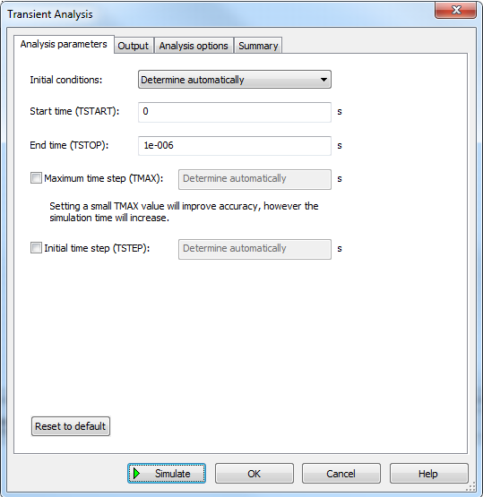

When simulating the circuit, please select Analyses: Transient Analysis from the simulate menu. This opens the Transient Analysis parameters window.
In the Analysis Parameters tab, set the start time at 0 and the end time to 1e-006.

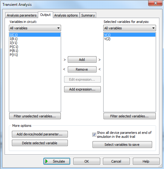

In the Output tab, add V(1) and V(2) to the selected variable list so that you can plot both the source voltage and the capacitor voltage.
Click the Simulate button and  a Grapher View window will appear showing your plot.

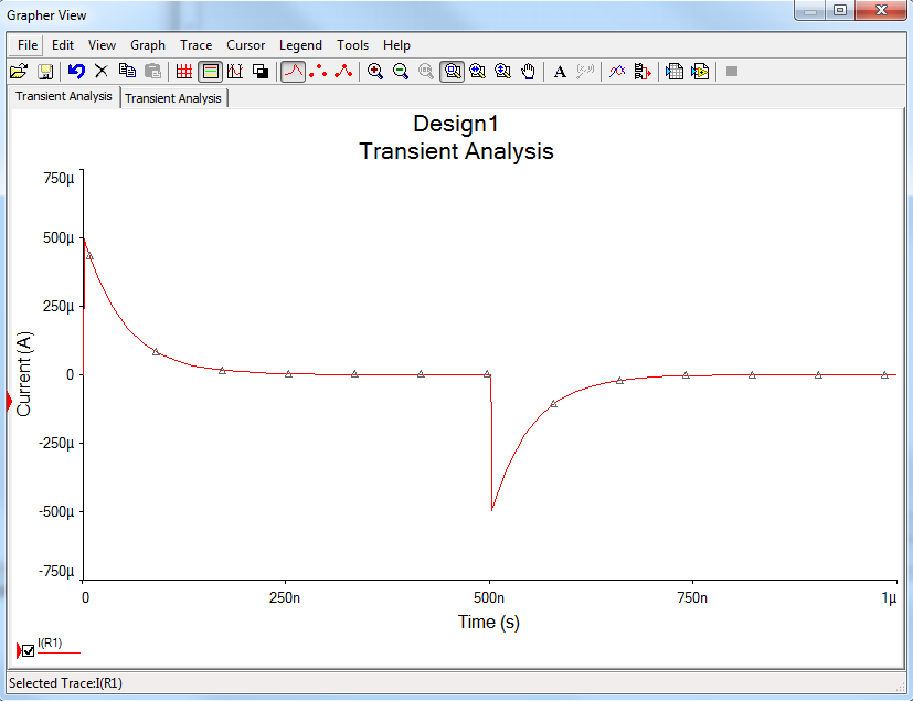

If you want see the current add I(R1) to the output tab and it will show a similar plot like the one below
When you have the output results, you can add cursors on the figures to see some cirtain values at cirtain time.
