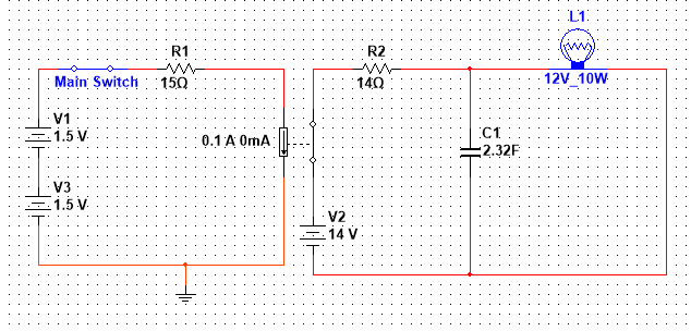

I am new to the world of electronics and I had done a simple circuit to verify the charging and discharging of a capacitor.
The circuit is as shown below:

(2) The capacitor is not charging upto 12V. Tha maximum voltage attained is 7.098 V.
Please help me understand these variations from the calculated value 😞

Simple Ohm's Law.  The final value of the capacitor voltage in a DC circuit will be the voltage at that point as if the capacitor had been removed.  Resistor R2 and lamp L1 create voltage divider so 7 V appears to be correct.
