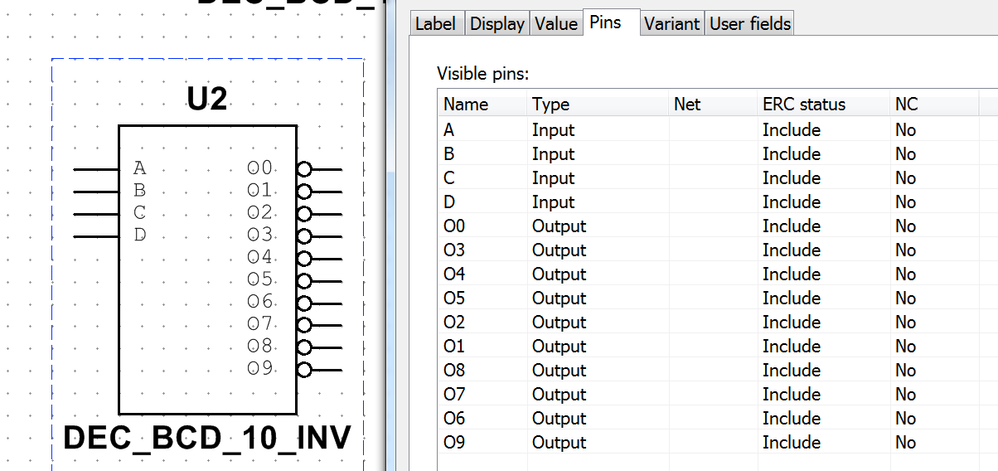

Recently, I use the DEC_BCD_10_INV component in Multisim to serve as a decoder in my circuit design. When I simulate the circuit in Multisim, the behaviors are as expected. However, when I export the PLD design into the Basys 3 FPGA board, strange things happen. The decoder does not work as expected. Instead, it works as follows:
4-bit binary number  The port which is in high voltage
0000                         O0
0001                         O3
0010                         O4
0011                         O5
0100                         O2
0101                         O1
0110                          O8
0111                          O7
1000                         O6
1001                         O9
Then I find that the problem may lie in the pin assignment of this decoder since the attribute of this component shows following information. The order of O0~O9 corresponds to the above strange results. However, I still don't know the exact reason behind it. Is there any reasonable interpretation regarding to this decoder?
