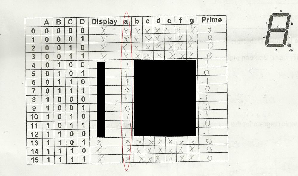

I'm a High School student and my school has a mandatory Digital Electronics course. We have a project due on Tuesday where we have breadboard a circuit to display our 9-digit school ID number on a Common Cathode LED. We first have to plan out and submit the circuit in Multisim. I assume I wired the switches correctly and rechecked my truth table and K-maps multiple times but certain segments on the LED are off when they should be on and vice versa. My teacher checked everyone's k-map and mine didn't have any errors. Can anyone tell me what I did wrong.
Here's the link to the file with the A-Segment wired:A-Seg
Here's the truth table and KMap:

You have at least one error in converting your truth table to K-map.  The row marked 6 in the truth table has a = 1 and ABCD = 0110. In the K-map A'B x CD' is 0.  Similarly row 7 is wrong. I did not check any further.

Isn't A'BCD' 1001?
(4,407 Views)
A'BCD'=0110
