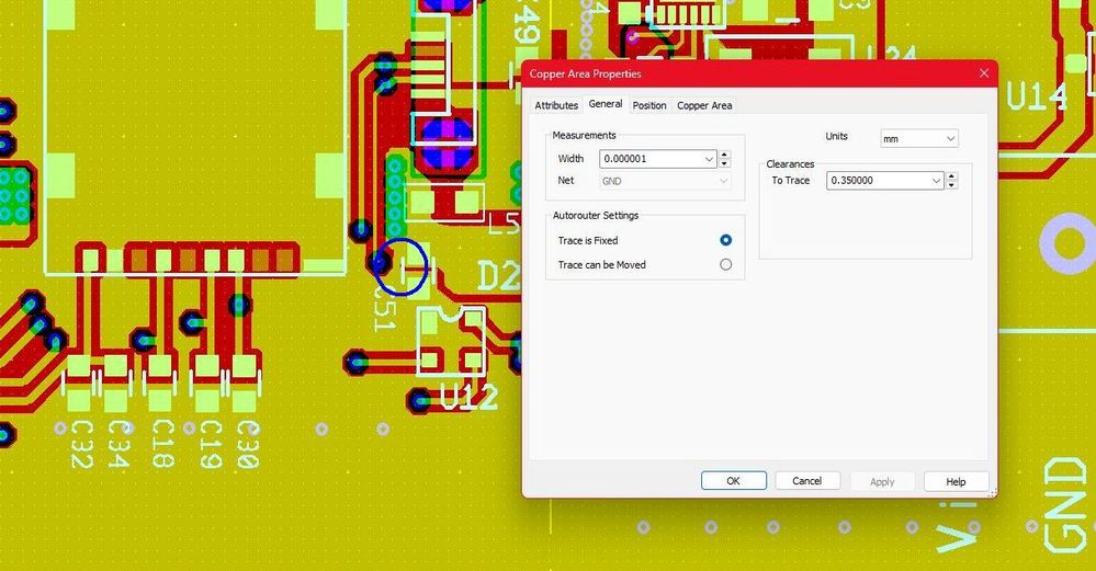

I recently had a shortcircuit in a customers PCB that was not detected by the DRC.
In the jpg below you can see a short over C51 (on the left of C51, in the blue circle).
The reason was this, the customer added a copper area in this zone with a 0.35 mm clearance but with a 0.000001 mm (= 1 nanometer) width.

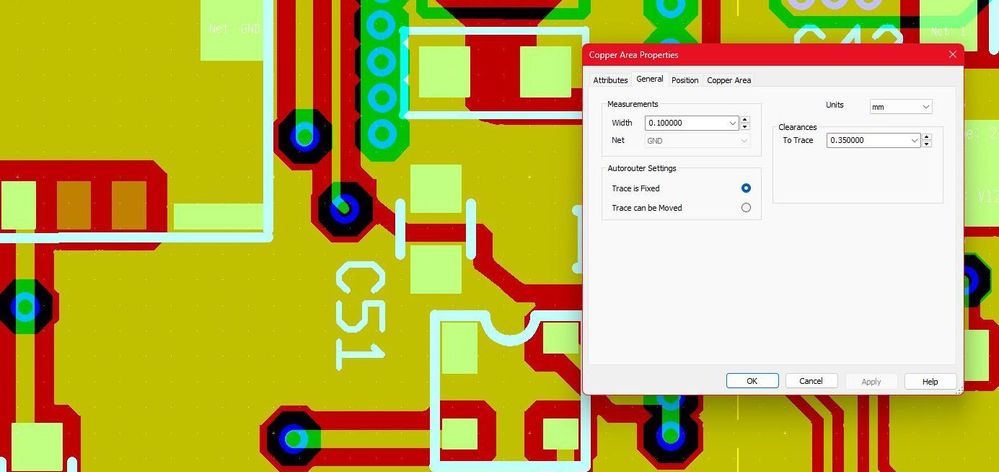

The problem was solved when I increased the width to 0.1 mm (picture below).
