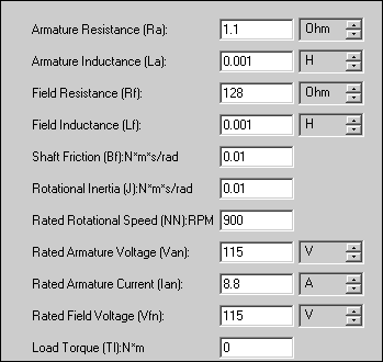

I think the problem lies within the standard values of the MOTOR_VIRTUAL. If you place a MOTOR_VIRTUAL, it has a relatively high load torque, which is larger than the torque the motor can drive at any voltage. If I use the following settings, and drive the Motor from 0-100V it works as expected.
See also attached an example file which implements an TTL encoder mounted on the motor axes.
