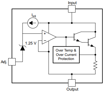

What I mean by that, is when I imported i.e. LM317 component, I'd like to change it's display mode into showing it's whole internals, like it's shown in it's functional block diagramlm317
instead of just image.
Is it possible or I have to recreate the circuit diagram by hand?

Thanks for image, but I was asking if it's possible somehow to convert this image into this lm317 using MultiSim.
I'd like to display the LM317 imported component as a functional block diagram circuit.
Your image won't help me anyway, because it can't be imported as a valid MultiSim component.
