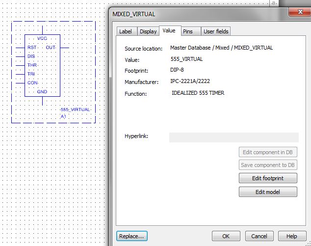

To add the footprint to your virtual part, in the schematic:
  • right click the 555 symbol and select properties.
  • Select edit footprint
  • select from data base
  • From the data base find the dip 8 part.
I just tried this and below is a screenshot after I followed the above steps.
Hope that helps.
(6,267 Views)

You should be able to add a footprint to a virtual symbol, but why not just use one of the 555 parts that has a Dip 8 footprint assigned. There are several in the Master Dbase. just use the filter in the search for 555.
Hope that helps.

There is no edit footprint-button on the 555's properties-window, I checked every tab.
Ehm, there's more than one 555 in the database? ...... the other one I just found (which has no footprint assigned) also can't be given a footprint through the spreadsheet view. However, that one does have an edit footprint-button on the properties window, thanks for the tip 🙂
Now to link the right pins of the footprint to the right pins of the 555, the only pin that seems to be correct is VCC (pin 8).
