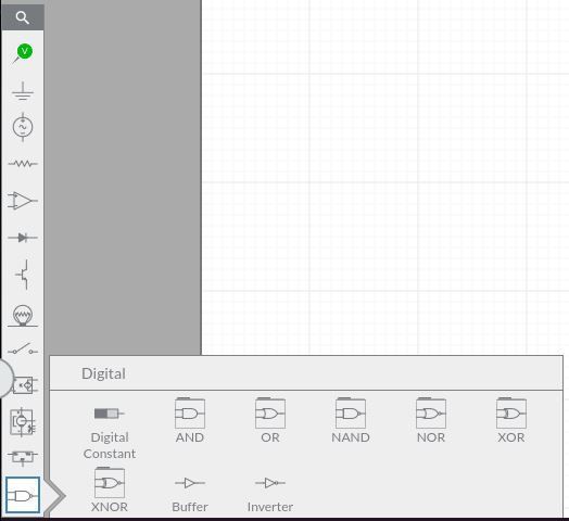

My students are unable to see the Digital Clock / Flip Flops & Latches / BCD to 7 Segment Decoders options in the Digital toolbar.  This is what their screen/options look like:

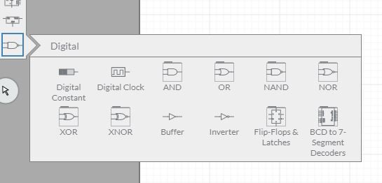

This is what my screen/options shows:

The digital components that you have available in the screenshot is from the Free tier.
Please have the students confirm that Account Access Level says Premium on the Profile settings page.
