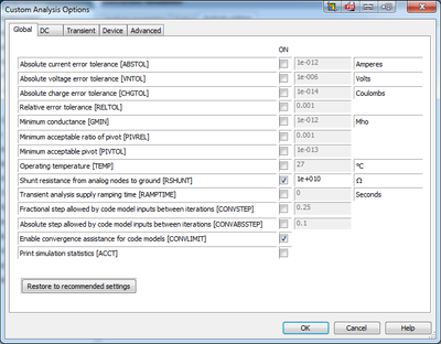

I have had similar problems..I changed the RSHUNT value in Custom analysis options and got the driver to work.
(2,377 Views)
Thanks! I also had to reduce the error tolerances but that was the missing link.
