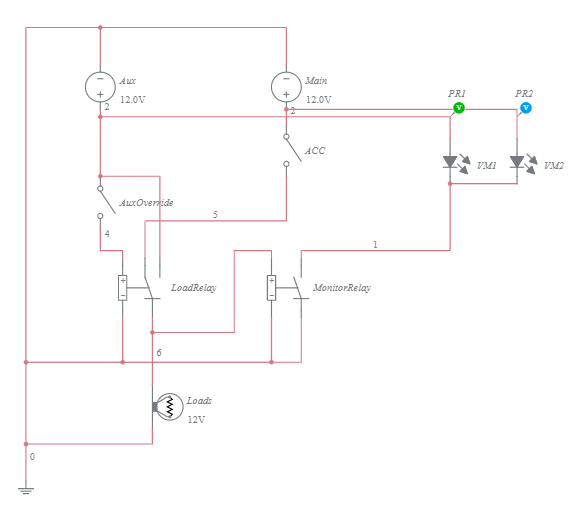

Hi, I'm trying to design a circuit with a double throw relay to choose between two batteries. I can't seem to avoid this error when running a Sim. Should this be possible? Thanks

Thankyou tipa, your example works. I cannot see what is wrong with this:
<a href=https://www.multisim.com/content/6s76QJHUSd797MQFMk9vWK/dualbattauxoverride/ target="_blank">
<img src=https://www.multisim.com/api/v1/image/2168686/6s76qjhusd797mqfmk9vwk-pngthumbnailcircuit/DualBattAux...><br>Multisim Live: DualBattAuxOverride
