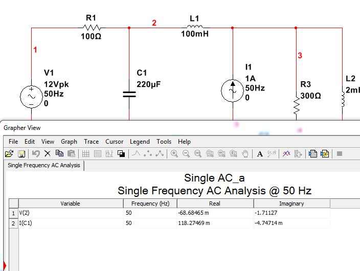

Since the voltage reading matches your calculation, I  took the reading at node 2 and divided it by XC1, I got the same as the answer as IC1 from Multisim.
Ic1 = V(2)/Xc1
     = -68.68-1.71127i / -14.4686i
     = 0.118274 - 4.774682i
I also tried other SPICE simulators and I got the same reading as well.
