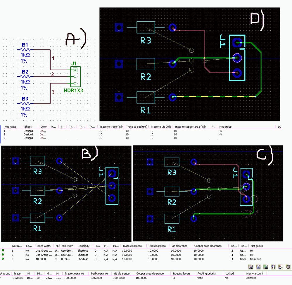

Hello,  To explain my problem I have prepared as easy example as it is possible.
Let suppose that we have a circuit diagram that is shown below in the attached figure (Figure A). As can be seen the circuit diagram consists of three resistors R1, R2, R3 and one connector J1. These parts are connected each other by three nets 1,2 and 3. Nets 1 and 2 is grouped into HV group with a Multisim clearance option (to trace, to pads, to copper parts) equal to 10 mil. In Ultiboard this HV group in Net Group Tab is set to clearance option (to trace, to pads, to copper parts) equal to 100. It results from the fact that both lines (1,2) exhibit, in example 1000V, while net 3 only 10V. Thus these nets, namely 1 and 2 posses internal clearance 10 mil to each other and external 100 mil with respect to the net 3. Up to now everything works fine but when we turn on the Autorouting option for a given geometry configuration (Figure B) it will produce complete disaster (Figure C). As can be seen in figure C), the Autorouter does not take into account the “Group HV” clearance to the pads. The green trace from Resistor R1 to connector J1 should look more likely like in Figure D.
My question is: Why the Ultiboard does not take into account the Group HV clearance to the pads. ??????
I was trying to solve this problem in many different ways.
In example, I have changed manually the pad clearance of a connector J1 to a given value. It works – the Autorouter will produce the result that looks like in figure D), but it will produce the clearance to each net independently of a net group that it belongs !!!!!.
In the J1 part pad clearance option one can set “Use net settings” – but it will produce only 10 mil clearance for pads. Why there are no option “Use Net Group settings” ????????? I mean that a clearance of a pad is different for different groups or nets !!!!!!!

I was thinking about this problem a lot and unfortunately I have found much more important problems that only this presented above !!!!!.
If someone look more precisely into Attached (above) figure C, one can immediately see that even the CRC check and Design Rule Check does not work properly in Multisim 11 !!!!!!!.
Namely. the low voltage red trace (net 3), that is of course wrong autorouted - goes to close to high voltage green nets 1 and 2 (close to connector j1),  is not underlined by red circle by Design Rule Check. In contradiction the bottom green trace (net 1) is underlined by Design Rule Check since it goes too close to pad of a connector J1 connected to net 3.
If some one suppose that autorouter does not work properly the Design Rule Check should does !!!!!!. This bug should have to be fixed ASAP (as soon as possible) or it may causes a lot of troubles !!!!

Hi Irocz,
I've created a test circuit similar to what you have shown and I can confirm that the Autorouter did violate the clearance settings.  But to be honest, with your setting and the component you selected it is not possible not violate the DRC errors.  The component J1, I am assuming this part is from the Master database, the center to center distance between the pins is 100 mil so it is not possible for you to route any trace with a 100 mils clearance to these pins without triggering the error.
I prefer to have one clearance setting each of my net, I don't like to have clearance setting to trace, via and pad separately and base on your comments, I think you would agree.  You can turn off the separate clearances setting by selecting Options>PCB Properties>>Design Rules, uncheck the "use multiple clearances" box and now your only clearance setting is trace clearance.
In general, if you have nets that you need to control such as the high voltage nets, I would recommend you manually route these using the Place>>Line method, you have full control where the wires goes and once you finished, lock down the traces and then use Ultiroute to route the rest of you PCB.

Hi Tien P,
Thank you very much for your response, it is of great importance for me.
I see that you do not understand how big mistakes have you made. To show this once again I have improved above presented example taking into account propositions of Tine P.  At first I have uncheck the "use multiple clearances" box and increase the distance between pins of a connector J1. Secondly I have routed manually, as proposed by Tine P, the high voltage nets. Then I have just simply push the autorouter button. The result is presented in the figure attached to this e-mail.
The low voltage green net is of course wrong autorouted. It goes to close to high voltage THTpads that also exhibit high voltage!!!!!!!.  But this is piece of cake. The biggest problem is that this problem is not underlined by DRC check rule and this is a complete disaster. In example, if I will produce 100000 of such PCB boards since I ma sure that there are no any DRC problems, who will be responsible for discharge between high voltage net and low voltage one close to the connector J1.
P.S. Unfortunately the proposition of Tien Pham makes the case even worst. Thus I was trying to fix this problem with "use multiple clearances" i.e. for THTpads.
P.S. For better understanding, I have attached the example Ultiboard file to this e-mail. After opening the file just simple push the autorouter button and try to find DRC error.

Hi Irocz,
If you don't want net 3 to come too close to pad 1 and 2 on the header, you can set the pad clearance to 100 mils.  Double click on the pad and select the "General" tab to change the clearance setting.
Attached is the modified file.
As for the design rule, select View>>clearances to turn on the clearances.  I like to use this to help me understand why I am getting DRC errors and in your example, I don't see any reason why Ultiobard should report a DRC error.
