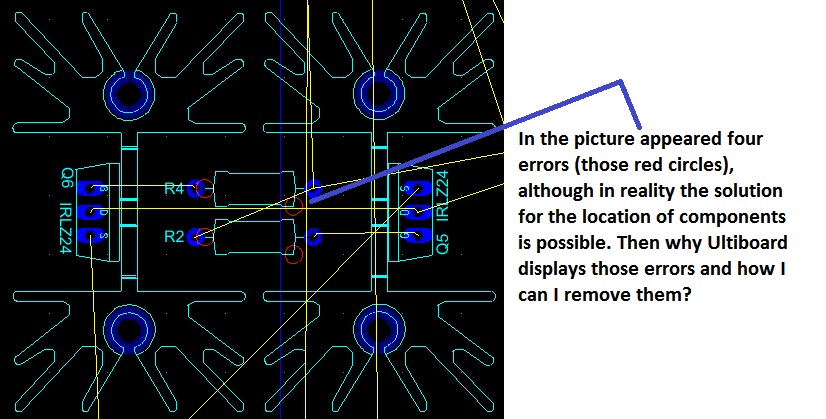

Please tell how to remove the four errors from the image below.
As seen in the image, the placement of electronic components is possible in reality but Ultiboard software does not understand this. How can I remove those errors. Some advice, please!

Those are Design Rule Errors. Go to the Spreadsheet View and select the DRC tab. What's the description of the error?
You can ignore the error by right-clicking the error and selecting Add to filter.
If you want attach your Ultiboard file for further troubleshooting, include info about your version.
