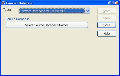

Over_Nyquest,
Also just as a reminder, to reuse your existing custom parts you may have created in a user or corporate DB in a previous version, you'll need to migrate/convert your DB:
1) Locate your v12 databae (from Multisim v12 or vXX)
...Options -> Global preferences (find the DB files under the 'Database Files' section)
2) Make a copy of the DB file (i.e. backup the database to a separate location) - this is not required (as it only copies the parts over) but I always do this as a best practice
3) (from Multsim v13) Use the Migrate/Convert DB tool in the new version
...  Tools -> Database -> Convert Database...
...this will convert all your parts in the old database and copy them into the databases you have set in v13 .... and then you should be good.
Note: These steps will copy both the symbol/models for Multisim and also any of the footprint shapes you've created for Ultiboard into the newest version...
Pat Noonan
(10,816 Views)
*Facepalm*  I spent all morning trying to figure out where my databace went.
Well... at least I know now.  Smiley Frustrated
Thank's for the heads up.
(10,806 Views)
