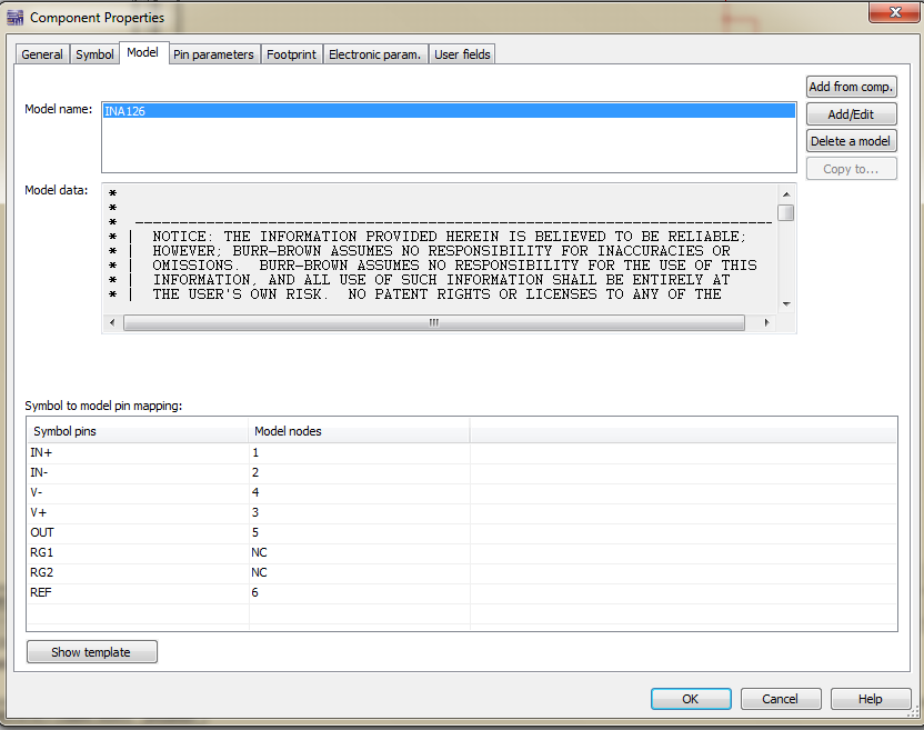

Hi Natasha,
Sorry I didn't reply yesterday but I had to leave work earlier.
So I tried to simulate the circuit you sent me but it is still not working.
When I do AC analysis the curves stay the same no matter what gain I configure it to have.
I tried looking for the NC pins you've mentioned but I couldn't find them so I'm sending you a screen dump of the tabs for the model.
This pictures show what I see when I open the file you sent me.
I apologise for my ignorance but to be fair I started with multisim a couple of weeks ago.
Thanks you for you patience.
Felipe

Felipe,
Configure the Model tab so that it matches the settings shown below. PSpice models and parameters are supported by Multisim, so this should not be an issue.
Natasha

Hi Natasha,
Thanks for you reply. You're probably getting tired of me by now. LoL
I did the changes you suggested and the model continues with the same problem, it doesn't model the behaviour of the component.
I change the gain through the resistor but in the AC analysis the plots are the same no matter what gain I choose.
I also didn't understand quite well where you said the error was. What I mean by this is that you said there was a discrepancy between my symbol pins and my spice model but I checked for this and I didn't see where I could be going wrong.
You said to change the 2 pins to NC, but in my spice model I need these 2 pins to connect a resistor to set the gain in my instrumentation amplifier.
If you simulate this circuit under AC analysis, does the gain vary when you use different values for R35?
If the gain varies then I probably have a problem with some setting in my multisim software fi it doesn't vary then I'm going to start to get desperate.
Anyway, thanks for all the help you've been providing and if you have any other ideas of what I'm doing wrong let me know.
