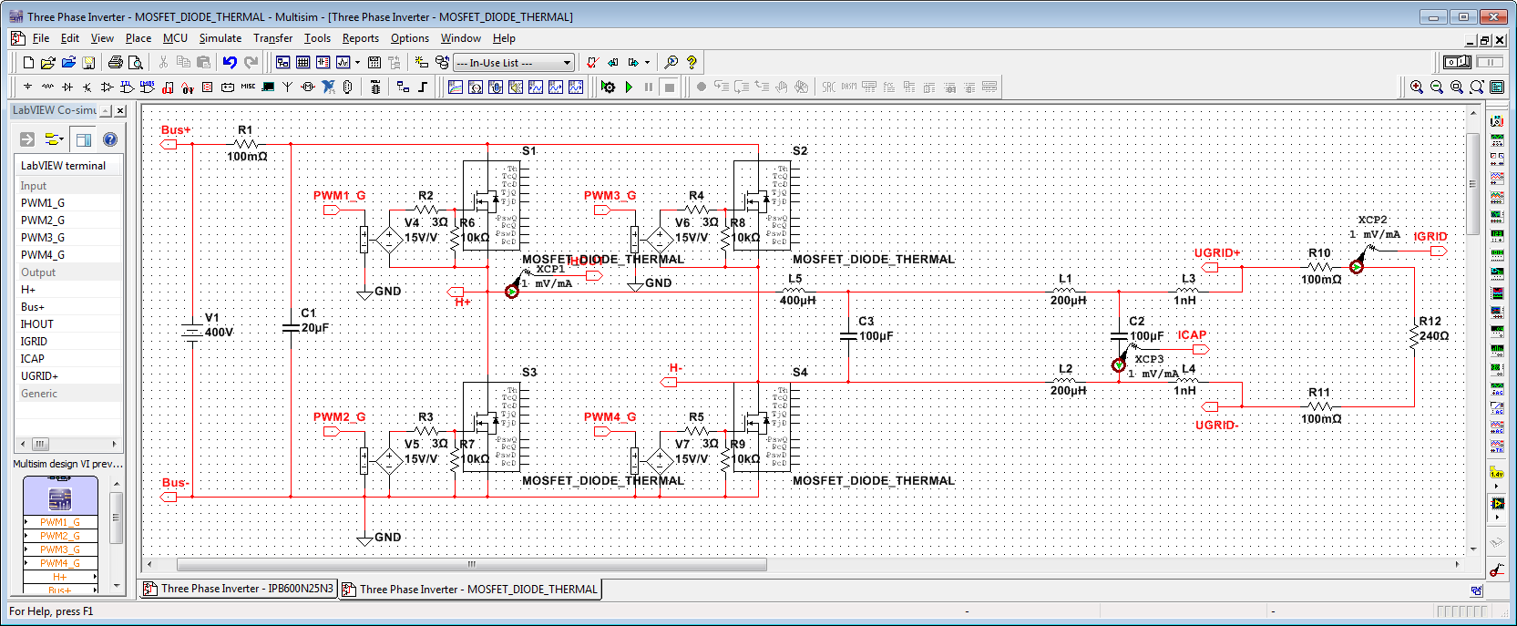

Below is the schematic with the MOSFET_THERMAL_DIODE model.
I didn't type in all the data from the vendor datasheet. I'll leave that for you to do. But I did fill in some of the basics.
Here is a simulation run with the MOSFET_DIODE_THERMAL models. Note that the simulation speed is 565 times slower than real-time, compared to 5590 times slower than real-time for the Infineon device physics-based SPICE model. That's roughly a 10X speed improvement. However, of course, the thermal model is not as detailed as a vendor SPICE model.
