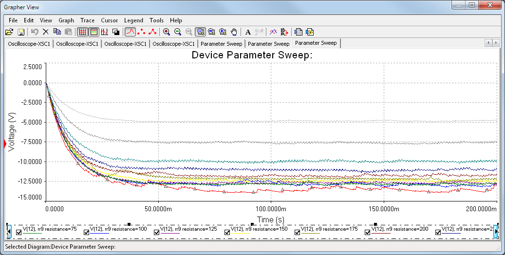

In this design, the resistor R9 is used to model the strain gauge sensor and a parametric sweep analysis is run to view the DC level of the output signal at various input points.
Here is a screenshot of the sweep analysis settings
And the results of the analysis, show that with every input point a different DC level is achieved, with a high Common Mode Rejection Ratio at a bandwidth up to a bandwidth of 10 kHz prvided by the AD8221 amplifier
