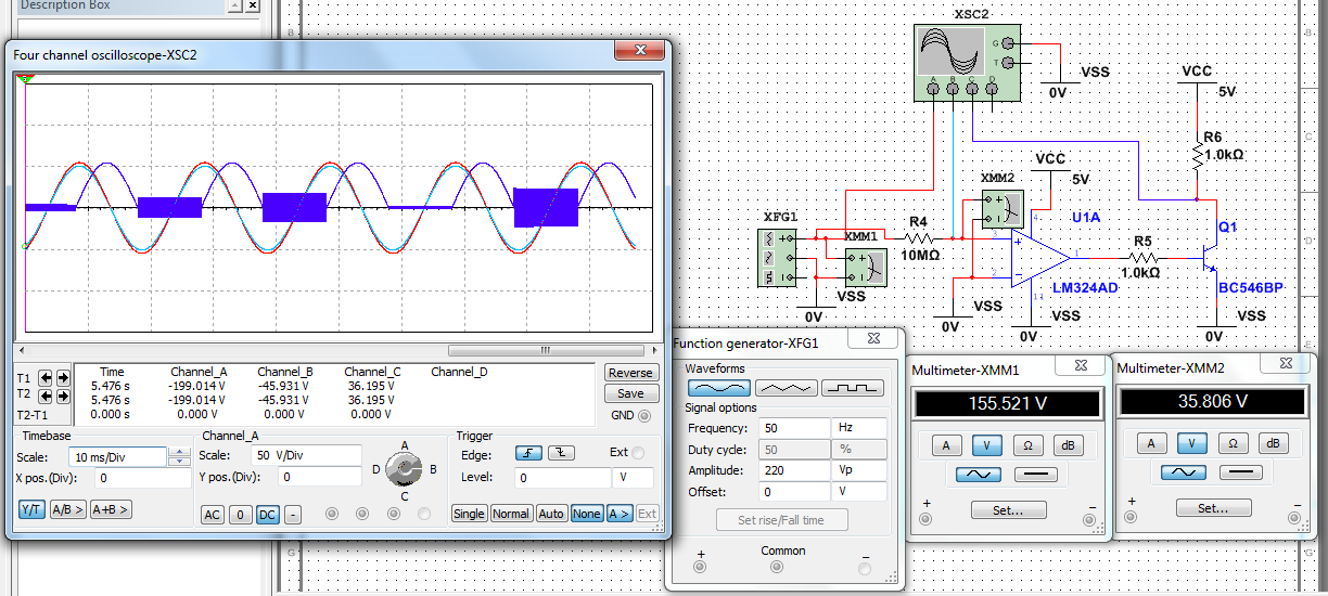

hello every one,
I'm trying to simulate a zero-crossing detector circuit on Multisim but it gives me a strange results !
I attached both the circuit and the result.
can anyone help me with that ?

hello Ahmed Elsayed,
I think the input voltage of the  OP may not exceed approx. 30 V. The amplitude of the sine input seemes to be more than 200 V.
With less or equal  25 V it will function very well.
I hope this helps.......

Hello Ienny
Thanks for replying, i do like you did in your attached image but it still give me strange results.
i beleive it's an error in the ciruit altough it is a simple one -comparator in any test book- and it is not a multisim bug !
here is the second exp. results.

Hello Ahmed,
I think your input voltage is still to high. I cannot reproduce your results.
Which model are you using for the LM324AD? There are six different models available in the main database.
I used the default model Motorola/LM224_6.
The model LM324_2 has no limitations with respect to the supply voltage of the OpAmp.
Hope this helps....
